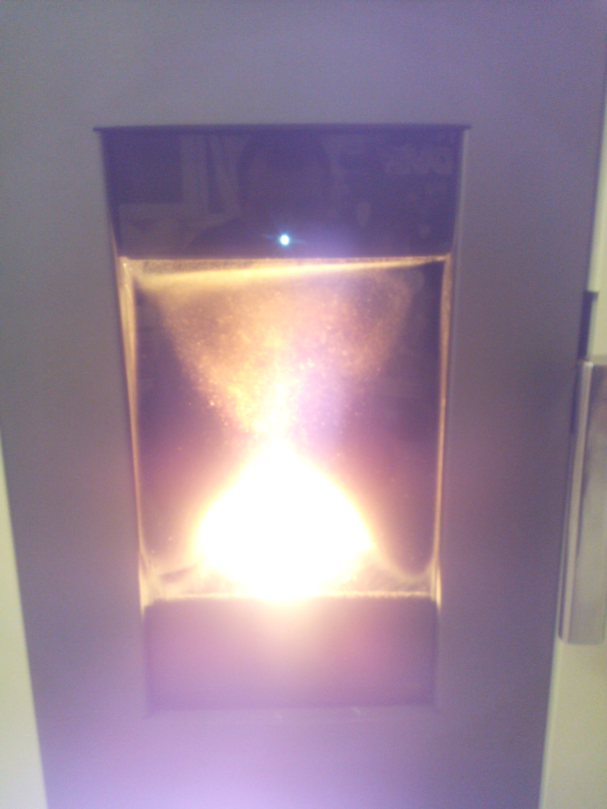

bmahob:
Hello people!
Can you tell me how you make glass of stove clear, my stove is with new basket for pellets with remove bulkhead! With more fan rpm, whit less NO EFFECT please tell me how you make it. And one more question how does a blocked chimney of the fireplace, you increase T of exhaust gases? Alfa Plamm Commo 21
[Ovu poruku je menjao bmahob dana 16.01.2017. u 11:19 GMT+1]
Im using Fairy dishwash liquid and 2 tissues. Its the best way to clean stove glass.

bmahob:
Hello people!
You don`t understanding me well, it is cleaning very easy with paper /because is only dust/ But i want to know why it became dirty too fast/my friends have same stoves and in the midle glass is clear mine i almost black after 3-4hours
