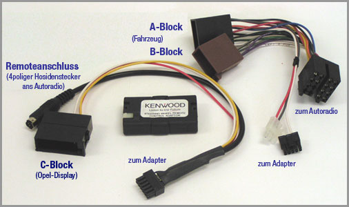

I isto to za kenwood aparate:
http://www.kenwood.de/WebFiles...log/car/car_06_cd-receiver.pdf
To je to:
http://www.kenwood.de/technologie/opel-display/
Ovako izgleda za kenwood:
