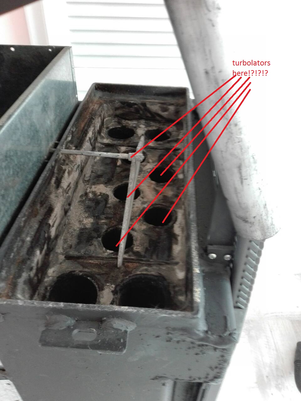

Re: ALFA PLAM COMMO 21kw pec na pelet za etazno 06.12.2017. u 14:38 · pre 108 meseci #4137
Hello
I have one question again see on picture somebody put turbolators on the short holes??? Picture

Re: ALFA PLAM COMMO 21kw pec na pelet za etazno 06.12.2017. u 14:44 · pre 108 meseci #4138
No.
Two holes on the left & right side

Re: ALFA PLAM COMMO 21kw pec na pelet za etazno 06.12.2017. u 16:54 · pre 108 meseci #4140
How you plan to clean that hole ?
Wich model you have ? Make a picture
