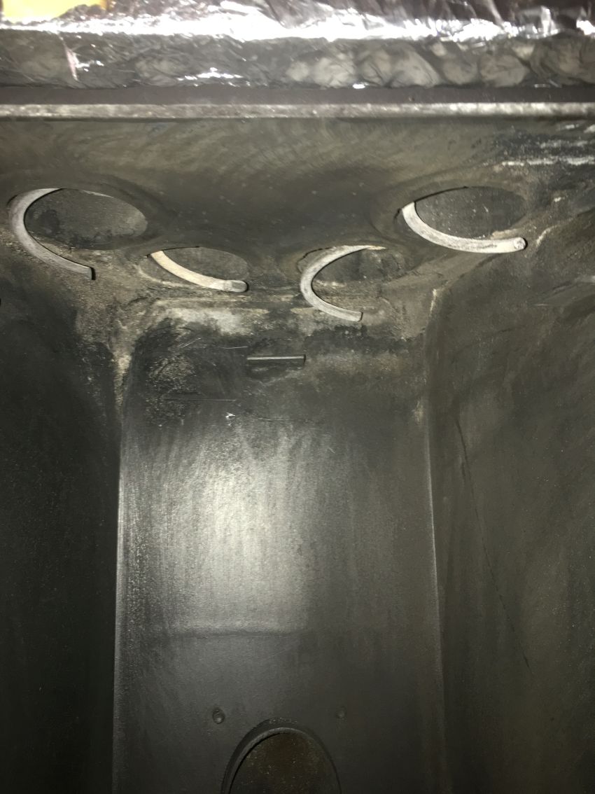

icon Re: ALFA PLAM COMMO 21kw pec na pelet za etazno06.12.2017. u 13:38 - pre 107 meseci
Hello
I have one question again see on picture somebody put turbolators on the short holes??? Picture
I make turbolators like Miruda and my exhaust T is
1 power -1500-105-110C
2 power -1650-110-120C
3power -1850-120-130C
4 power -2050-130-140C
5 power -2350-150-160C

icon Re: ALFA PLAM COMMO 21kw pec na pelet za etazno06.12.2017. u 13:44 - pre 107 meseci
No.
Two holes on the left & right side
Commo Compact 23KW
Dva objekta (40+50m2), prelazne cevi 3m (izolovano)
Bez izolacije,drveni prozori.
(21,4), panelni radijatori 7,3m (6kom), sušač, termoglave,
meh.mešni ventil, bežični sobni termostat Salus.

icon Re: ALFA PLAM COMMO 21kw pec na pelet za etazno06.12.2017. u 14:44 - pre 107 meseci
Hm because in Bulgariawe have two new models which have turbolators and there and they have very low T of exhaust between 65-95C see [url=mailto:https://forum.napravisam.bg/do...le.php?id=117193&mode=view]Picture 1[/url]
This one is under holes
See scheme

icon Re: ALFA PLAM COMMO 21kw pec na pelet za etazno06.12.2017. u 15:54 - pre 107 meseci
How you plan to clean that hole ?
Wich model you have ? Make a picture
